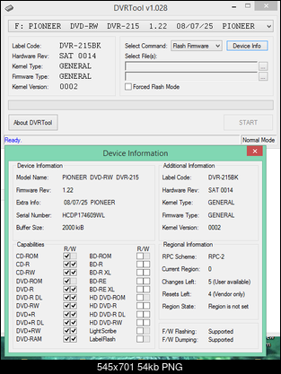

Stary 15.03.2016, 13:03   #138
Posty: 22,800
DVRTool 1.028 Beta
Flash\Crossflash Pioneer DVR-109DB ( Medion ) do Pioneer DVR-109 (Pioneer)
DVRTool v1.0 - firmware flashing utility for Pioneer DVR/BDR drives-2016-03-15_11-12-55.png
DVRTool v1.0 - firmware flashing utility for Pioneer DVR/BDR drives-2016-03-15_11-13-29.png
DVRTool v1.0 - firmware flashing utility for Pioneer DVR/BDR drives-2016-03-15_11-16-02.png
DVRTool v1.0 - firmware flashing utility for Pioneer DVR/BDR drives-2016-03-15_11-16-58.png
DVRTool v1.0 - firmware flashing utility for Pioneer DVR/BDR drives-2016-03-15_11-18-06.png
czary2mary jest offline

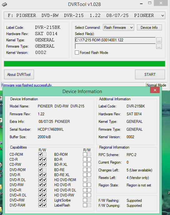

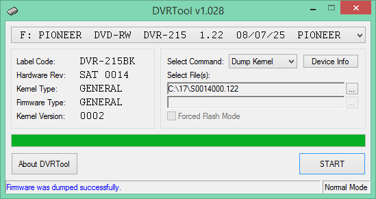

Posty: 22,800

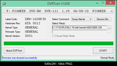

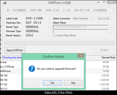

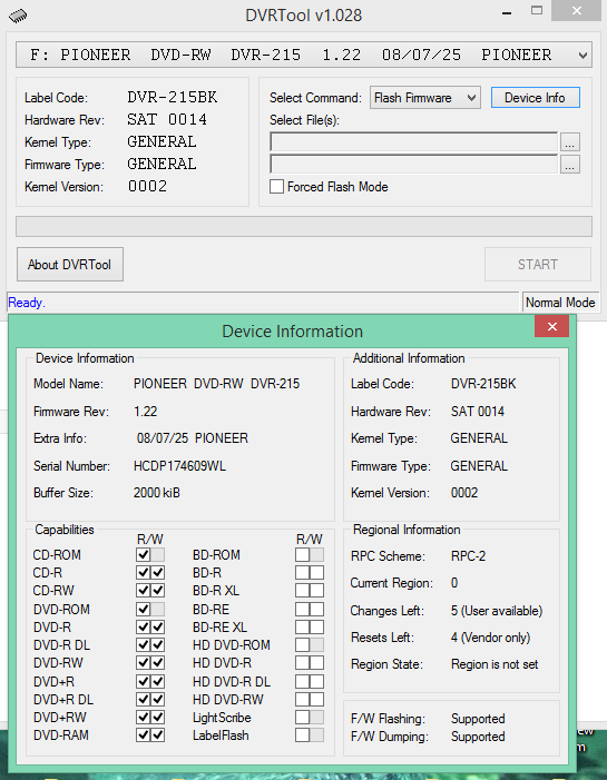

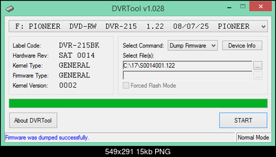

DVRTool 1.028 Beta
Pioneer DVR-215 BK -przywrócony dziś do życia ..... \ info\ dump\flash
DVRTool v1.0 - firmware flashing utility for Pioneer DVR/BDR drives-2016-03-18_16-08-42.png
DVRTool v1.0 - firmware flashing utility for Pioneer DVR/BDR drives-2016-03-18_16-09-13.png
DVRTool v1.0 - firmware flashing utility for Pioneer DVR/BDR drives-2016-03-18_16-09-40.png
DVRTool v1.0 - firmware flashing utility for Pioneer DVR/BDR drives-2016-03-18_16-16-01.png
DVRTool v1.0 - firmware flashing utility for Pioneer DVR/BDR drives-2016-03-18_16-17-16.png

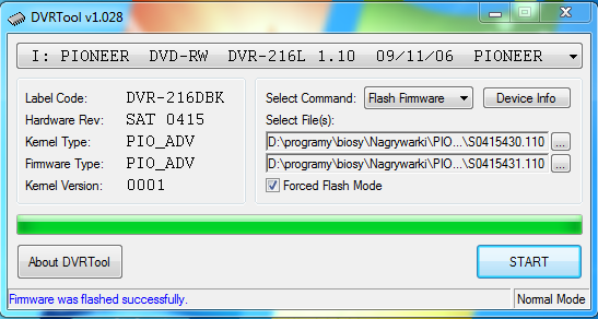

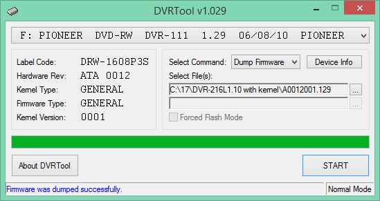

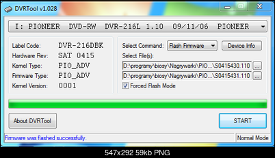

Posty: 22,800

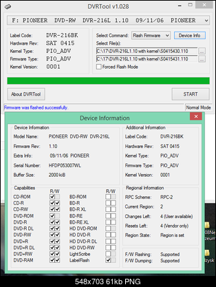

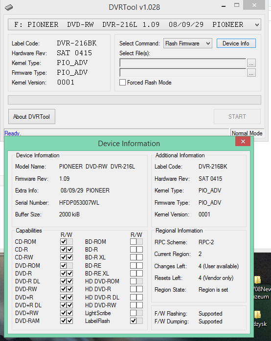

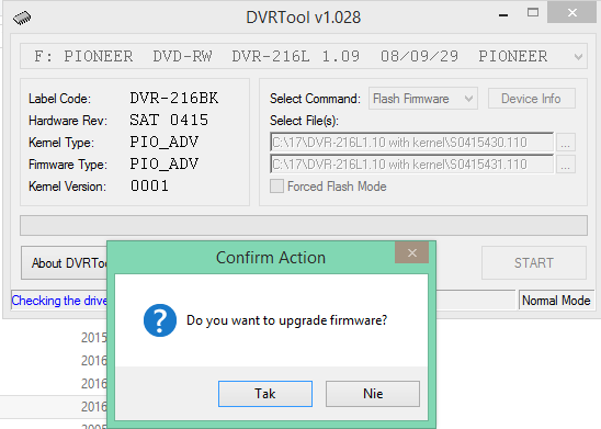

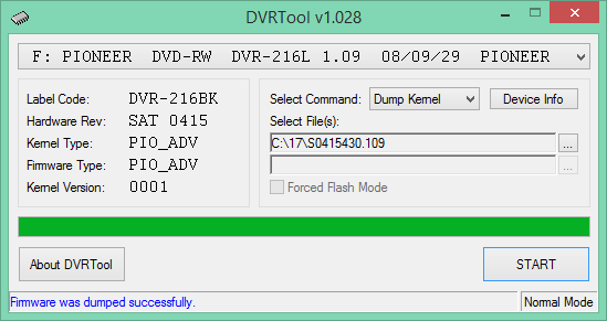

DVRTool 1.028 Beta
Pioneer DVR-216L dump\ flash firmware 1.10
DVRTool v1.0 - firmware flashing utility for Pioneer DVR/BDR drives-2016-03-20_07-46-53.png
DVRTool v1.0 - firmware flashing utility for Pioneer DVR/BDR drives-2016-03-20_07-48-09.png
DVRTool v1.0 - firmware flashing utility for Pioneer DVR/BDR drives-2016-03-20_07-48-33.png
DVRTool v1.0 - firmware flashing utility for Pioneer DVR/BDR drives-2016-03-20_07-49-02.png
DVRTool v1.0 - firmware flashing utility for Pioneer DVR/BDR drives-2016-03-20_07-50-03.png

216D---216L 1.10
dało by rady dodać informacje jak jest w Flasherah Lite-ON
tj. że potwierdzasz wgranie fw. czy to crosflash i jest podane
że z 216D v1.09 do 216L v1.10
albo sama informacja 1.09--->1.10

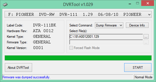

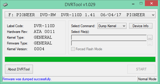

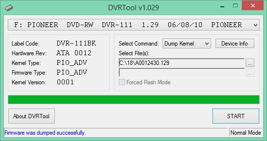

Posty: 22,800

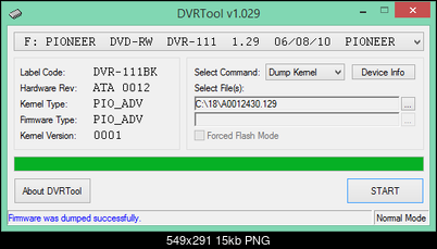

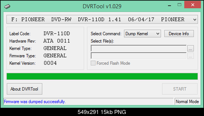

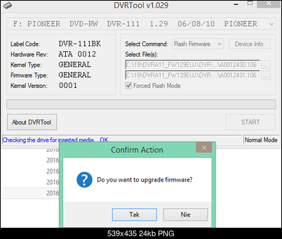

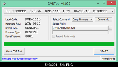

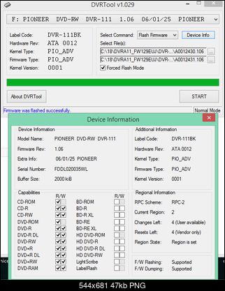

DVRTool 1.029 Beta
Dodany algorytm szyfrowania od ala42 - teraz dump DVR-110/111/K16/K06 również jest możliwy..
@Blackened2687
Tyle zdążyłem po nocce zrobić zamiast śniadania.. jak coś jeszcze znajdę to przetestuje \ cały majdan wysłałem już Tobie ....
@Seku \ @Leman39 -nowa wersja wysłana dla was
Prośba o przetestowanie dump na DVR-110/111/K16/K06 co macie \ przesłanie wyników dla mnie lub do @Blackened2687 ......czas start...
DVRTool v1.0 - firmware flashing utility for Pioneer DVR/BDR drives-2016-03-21_05-45-58.png
DVRTool v1.0 - firmware flashing utility for Pioneer DVR/BDR drives-2016-03-21_05-46-38.png
DVRTool v1.0 - firmware flashing utility for Pioneer DVR/BDR drives-2016-03-21_05-52-22.png
DVRTool v1.0 - firmware flashing utility for Pioneer DVR/BDR drives-2016-03-21_05-55-20.png
DVRTool v1.0 - firmware flashing utility for Pioneer DVR/BDR drives-2016-03-21_06-01-35.png
DVRTool v1.0 - firmware flashing utility for Pioneer DVR/BDR drives-2016-03-21_06-01-59.png
DVRTool v1.0 - firmware flashing utility for Pioneer DVR/BDR drives-2016-03-21_06-04-39.png
DVRTool v1.0 - firmware flashing utility for Pioneer DVR/BDR drives-2016-03-21_06-05-04.png

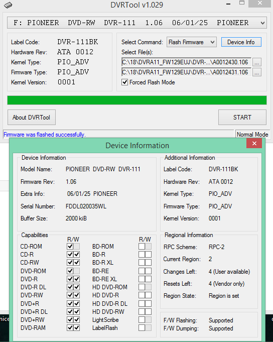

Stary 21.03.2016, 08:26   #150
Posty: 22,800
DVRTool 1.029 Beta
DVRTool v1.0 - firmware flashing utility for Pioneer DVR/BDR drives-2016-03-21_06-38-54.png
DVRTool v1.0 - firmware flashing utility for Pioneer DVR/BDR drives-2016-03-21_06-40-19.png
DVRTool v1.0 - firmware flashing utility for Pioneer DVR/BDR drives-2016-03-21_06-41-25.png
DVRTool v1.0 - firmware flashing utility for Pioneer DVR/BDR drives-2016-03-21_06-42-32.png
DVRTool v1.0 - firmware flashing utility for Pioneer DVR/BDR drives-2016-03-21_06-45-48.png
DVRTool v1.0 - firmware flashing utility for Pioneer DVR/BDR drives-2016-03-21_06-46-15.png
