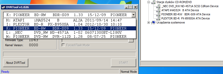

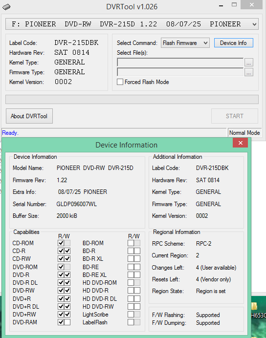

Plextor 755A Info
DVRTool v1.0 - firmware flashing utility for Pioneer DVR/BDR drives-przechwytywanie01.png
seku jest offline

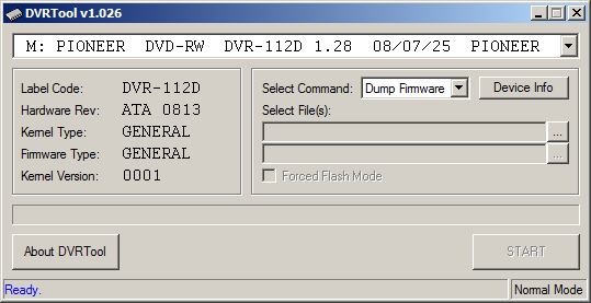

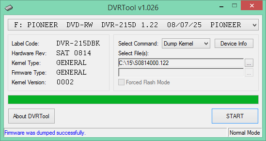

216D--->216L
DVRTool v1.0 - firmware flashing utility for Pioneer DVR/BDR drives-przechwytywanie02.png
216L 1.06 ---> 216L 1.09
DVRTool v1.0 - firmware flashing utility for Pioneer DVR/BDR drives-przechwytywanie03.png
zgranie kernel z 216L 1.09 pełen sukces

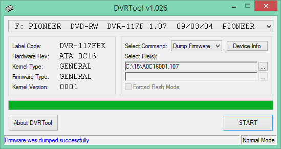

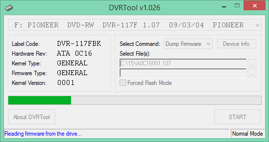

Stary 17.02.2016, 16:15   #96

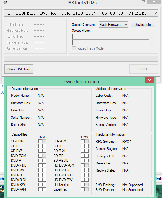

Posty: 22,800
Taka tam zbieranina co pod rękę podeszło ...

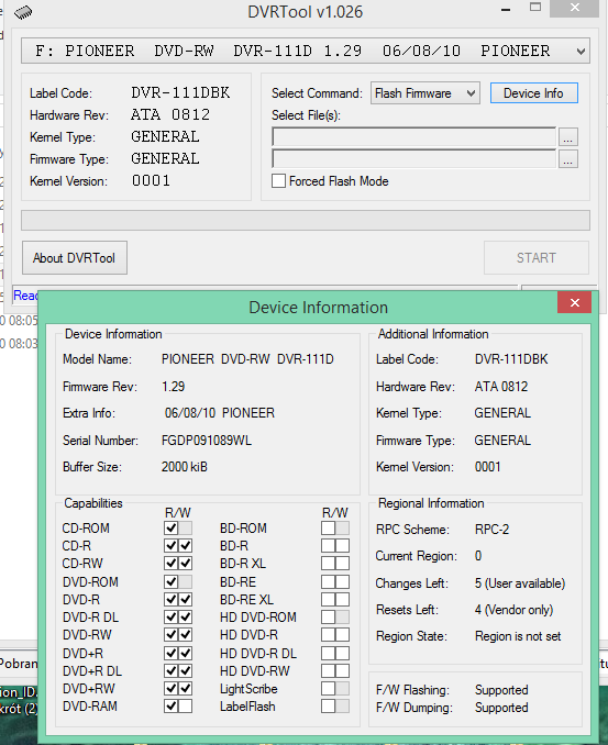

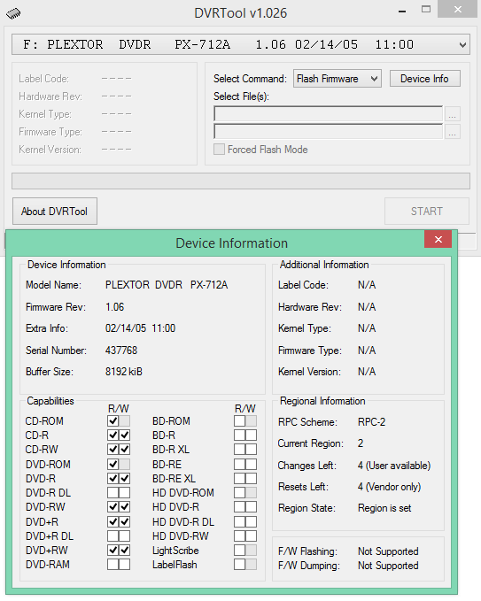

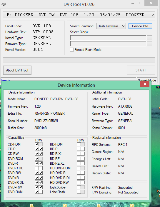

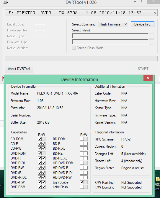

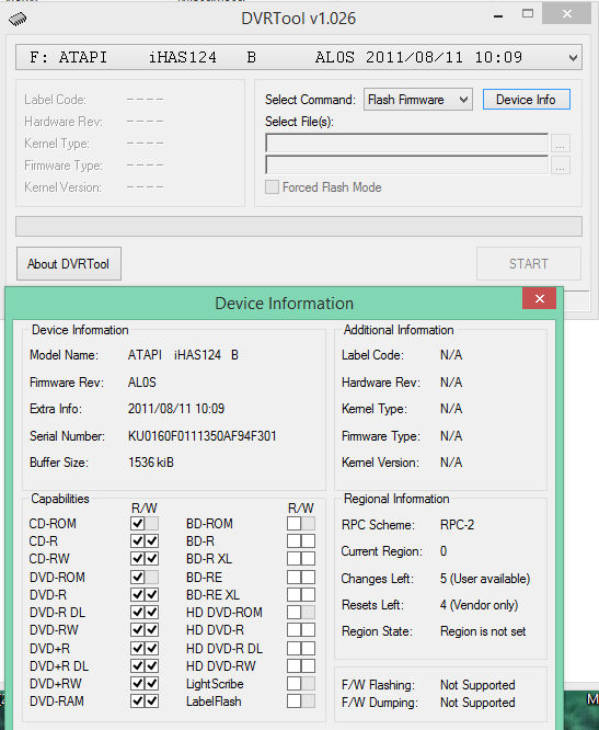

DVRTool v1.0 - firmware flashing utility for Pioneer DVR/BDR drives-2016-02-15_15-11-26.png
DVRTool v1.0 - firmware flashing utility for Pioneer DVR/BDR drives-2016-02-17_06-18-21.png
DVRTool v1.0 - firmware flashing utility for Pioneer DVR/BDR drives-2016-02-17_06-30-49.png
DVRTool v1.0 - firmware flashing utility for Pioneer DVR/BDR drives-2016-02-17_07-20-58.png
DVRTool v1.0 - firmware flashing utility for Pioneer DVR/BDR drives-2016-02-17_09-47-20.png
DVRTool v1.0 - firmware flashing utility for Pioneer DVR/BDR drives-2016-02-17_09-54-41.png
DVRTool v1.0 - firmware flashing utility for Pioneer DVR/BDR drives-2016-02-17_11-26-37.png
czary2mary jest offline

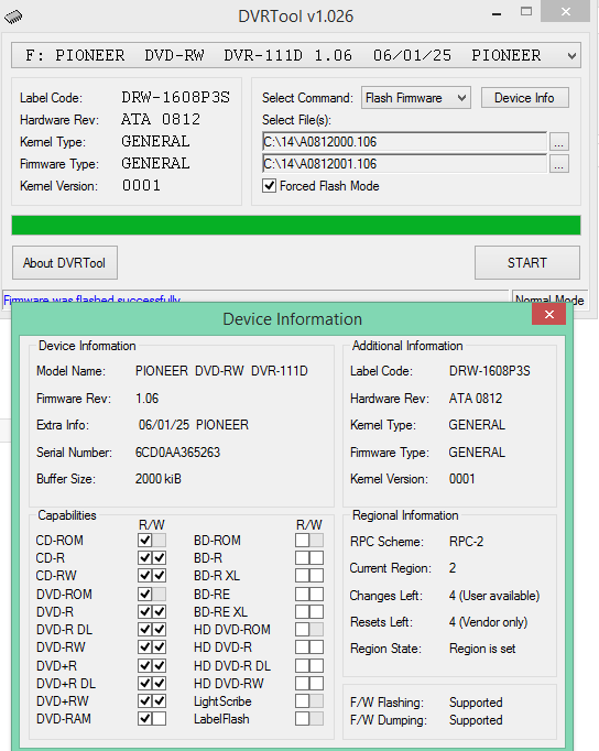

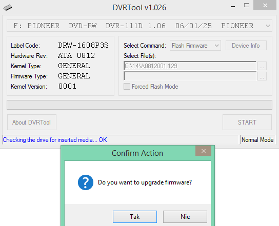

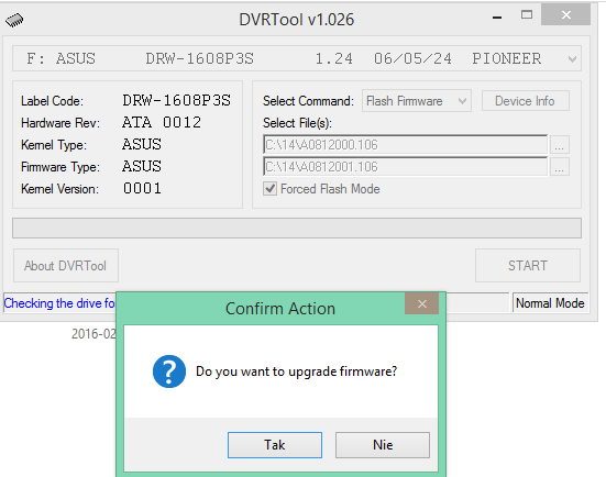

Stary 19.02.2016, 10:58   #97
Posty: 22,800
Crossflash\ flash Asus DRW1608P3S do Pioneer DVR-111D + zbieranina co pod rękę podeszło ...
DVRTool v1.0 - firmware flashing utility for Pioneer DVR/BDR drives-2016-02-18_16-51-14.png
DVRTool v1.0 - firmware flashing utility for Pioneer DVR/BDR drives-2016-02-18_17-06-05.png
DVRTool v1.0 - firmware flashing utility for Pioneer DVR/BDR drives-2016-02-18_17-07-17.png
DVRTool v1.0 - firmware flashing utility for Pioneer DVR/BDR drives-2016-02-18_17-08-06.png
DVRTool v1.0 - firmware flashing utility for Pioneer DVR/BDR drives-2016-02-18_17-10-06.png
DVRTool v1.0 - firmware flashing utility for Pioneer DVR/BDR drives-2016-02-18_17-11-09.png
DVRTool v1.0 - firmware flashing utility for Pioneer DVR/BDR drives-2016-02-19_06-50-57.png
DVRTool v1.0 - firmware flashing utility for Pioneer DVR/BDR drives-2016-02-19_08-13-34.png
DVRTool v1.0 - firmware flashing utility for Pioneer DVR/BDR drives-2016-02-18_16-37-09.png
DVRTool v1.0 - firmware flashing utility for Pioneer DVR/BDR drives-2016-02-19_08-28-52.png

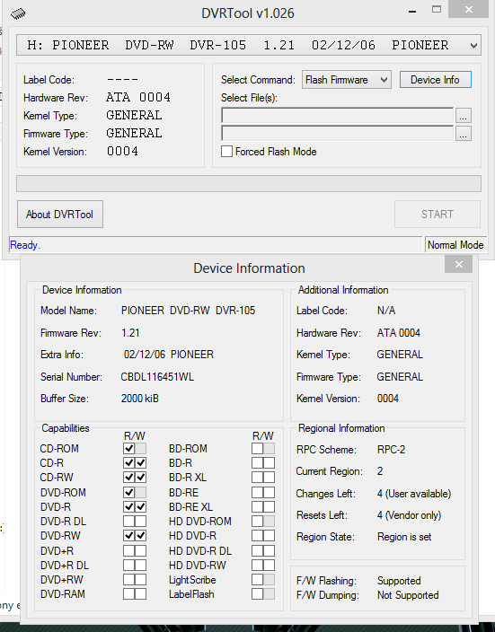

Stary 22.02.2016, 08:02   #98
Posty: 22,800
DVRTool 1.026a Beta
Małe ale dobre poprawki...następna wersja już powinna wspierać szyfrowanie firmware dla konstrukcji Pioneer DVR-110 / DVR-111 i ich prawidłowe zgrywanie
DVRTool v1.0 - firmware flashing utility for Pioneer DVR/BDR drives-2016-02-22_06-44-24.png
DVRTool v1.0 - firmware flashing utility for Pioneer DVR/BDR drives-2016-02-22_06-45-14.png
DVRTool v1.0 - firmware flashing utility for Pioneer DVR/BDR drives-2016-02-22_06-45-33.png
DVRTool v1.0 - firmware flashing utility for Pioneer DVR/BDR drives-2016-02-22_06-46-03.png

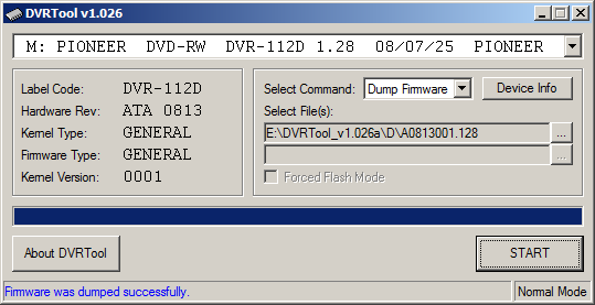

Stary 22.02.2016, 17:19   #99
Leman39
Avatar użytkownika Leman39
Data rejestracji: 21.02.2014
Lokalizacja: NS2
Posty: 2,422
Na początku bardzo dziękuję za udostępnienie wersji beta

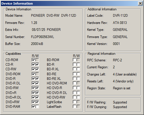

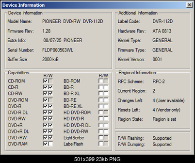

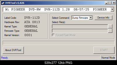

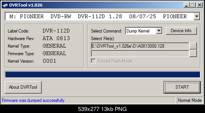

Pioneer DVR-112D w obudowie od Plextor PX-755UF:
Info poprawne:
DVRTool v1.0 - firmware flashing utility for Pioneer DVR/BDR drives-112_info.png
DVRTool v1.0 - firmware flashing utility for Pioneer DVR/BDR drives-112_device-information.png
Dump zgrywa:
DVRTool v1.0 - firmware flashing utility for Pioneer DVR/BDR drives-112_fwdump.png
DVRTool v1.0 - firmware flashing utility for Pioneer DVR/BDR drives-112_kerneldump.png

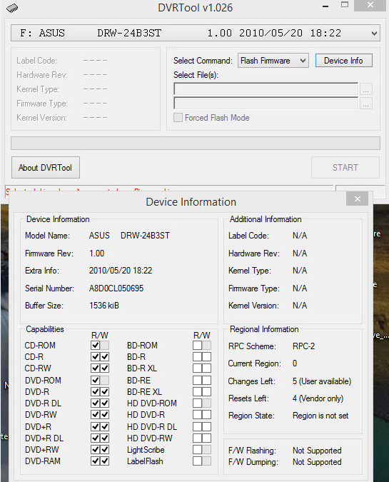

Stary 23.02.2016, 09:01   #100
Posty: 22,800
@Leman39
U mnie też nie znika ale nie ma to żadnego wpływu na nic ...
DVRTool v1.0 - firmware flashing utility for Pioneer DVR/BDR drives-2016-02-23_06-56-01.png
DVRTool v1.0 - firmware flashing utility for Pioneer DVR/BDR drives-2016-02-23_06-56-46.png
DVRTool v1.0 - firmware flashing utility for Pioneer DVR/BDR drives-2016-02-23_06-56-59.png
DVRTool v1.0 - firmware flashing utility for Pioneer DVR/BDR drives-2016-02-22_13-15-08.png
DVRTool v1.0 - firmware flashing utility for Pioneer DVR/BDR drives-2016-02-23_07-28-45.png
DVRTool v1.0 - firmware flashing utility for Pioneer DVR/BDR drives-2016-02-23_07-25-53.png
DVRTool v1.0 - firmware flashing utility for Pioneer DVR/BDR drives-2016-02-23_07-26-29.png
DVRTool v1.0 - firmware flashing utility for Pioneer DVR/BDR drives-2016-02-23_07-26-53.png

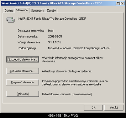

Pioneer DVR219L:
DVRTool v1.0 - firmware flashing utility for Pioneer DVR/BDR drives-2016-02-24-12_42_29-dvrtool-v1.026.png
DVRTool v1.0 - firmware flashing utility for Pioneer DVR/BDR drives-2016-02-24-12_43_00-device-information.png
DVRTool v1.0 - firmware flashing utility for Pioneer DVR/BDR drives-2016-02-24-12_43_52-wlasciwosci_-intel-r-ich7-family-ultra-ata-storage-controllers-27df.png

Stary 24.02.2016, 15:11   #102
Posty: 22,800
Okey
Miałem nadzieję, że to nie tylko u mnie
Pioneer DVR219L:
To klon QSI DDW-242\242S (chipset Mediatek MT1839LN+ OPU Hitachi HOP-356M ) więc nie ma szans żeby pracował z programem do prawdziwych Pioneer . Z tego co pamietam również te chipsety MediaTek były jakoś specjalnie po blokowane w wersji dla QSI\Pioneer ..Nie wiem czy DosFlashV2.0 da radę zgrać \wgrać cokolwiek z\do tych klonów QSI....Przy okazji sprawdzę ...

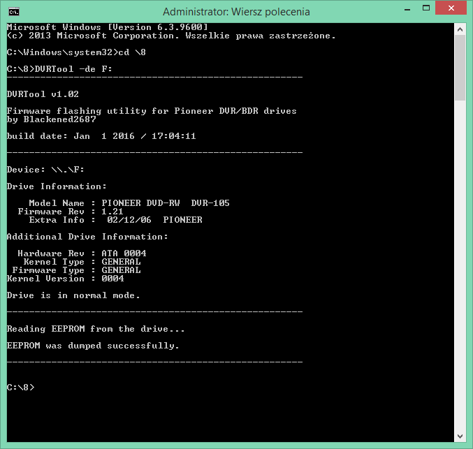

Stary 29.02.2016, 18:38   #103
Posty: 22,800
Pioneer DVR-A05
@Blackened2687 Eeprom zgrany i dołączony do reszty info...

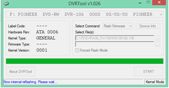

Stary 02.03.2016, 15:30   #104
Posty: 22,800
Pioneer DVR-A06
DVRTool v1.0 - firmware flashing utility for Pioneer DVR/BDR drives-magical-snap-2016.03.02-13.22-001.png
DVRTool v1.0 - firmware flashing utility for Pioneer DVR/BDR drives-2016-03-02_14-18-55.png
DVRTool v1.0 - firmware flashing utility for Pioneer DVR/BDR drives-2016-03-02_14-19-43.png
DVRTool v1.0 - firmware flashing utility for Pioneer DVR/BDR drives-2016-03-02_14-20-04.png
DVRTool v1.0 - firmware flashing utility for Pioneer DVR/BDR drives-2016-03-02_14-17-33.png
