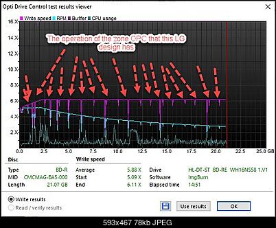

The screenshot shows that the drive's OPC is unable to set the laser power for a 6x write ratio. The drive won't even start recording or pass the OPC test for this write strategy.
As I mentioned, these drives are not designed to work with computers or PC programs outside of the VinPower platform and drivers.
Same thing using Imgburn when I tried at 8x. Might work without OPC but not recommended.

OPC always works in drives - it cannot be disabled / In imgburn we can only enable/disable the external OPC calculator of this program, which in no case disables the OPC system in the drive.
That's news to me. I always assumed that the drive just uses the write strategy and the laser power that's stored in the firmware. And with OPC enabled it uses a small section on the disc to test this and finetunes the strategy stored in firmware and then continues with that modified startegy/ laser power.
I just googled that there is also Running OPC while writing to optimize laser power. However, in this case the burn fails right after doing the OPC in the test area. So ROPC doesn't even come into play if the drive is doing / can do that.

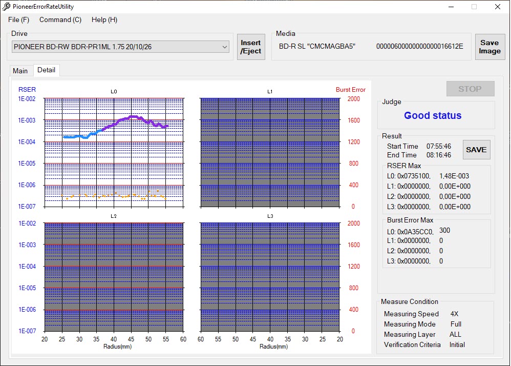

Stingray
Data rejestracji: 12.02.2024
Posty: 173
Stingray zaczyna zdobywać reputację <1 - 49 pkt>
Napisany przez Oinker Podgląd Wiadomości
the drive wouldn't write to BD-Rs
So far, I've done three successful cross-flashes. But my goal was Q scanning BD-R|RE, I also checked recording, but reading UHD isn't important to me.
In all three cases, after the first installation of firmware 1.v5, the drive had problems with BD-R/RE. I simply did another reflash of 1.v5 Mk - no MK, 1.v5 no MK - 1.v5 MK or 1.v5 ->1.v7. After that, there were no problems with MID that you mentioned. But remember, ASUS 3.11fw has more options for writing at high speeds for your MID code than Vinpower fw.
a screen below -I performed multisession recording and you can see all available speed options for MID: CMCMAG-BA5. This MID code varies greatly in quality.

It's very possible there's a problem with the 1.V5 firmware, but at what stage and who did something wrong is hard to say. This isn't our firmware. I don't know how it was copied from the Vinpower drive, or how it was prepared/edited.
Our 1.V.1 firmware supports 6/8x writes for CMCMAGBA5 media.
Crossflash BluRay LG\ ASUS-Asus BW-B1ST &quot;a&quot;D1XT\BW16D1HT-LG BH14NS40 \ BH16NS40-2025-12-16_07-08-08.jpg
Regarding OPC:
If the external calculator in Imgburn is enabled or disabled, it has no effect on the drive. Disabling OPC for the drive would require extensive modifications to the drive's firmware. The LG NVC:50/51/55/58 models, like all LG models, have zoned OPC, which is always active, as seen on every write run. OPC checks the error rate multiple times every few zones via the ERC block and corrects the laser power and beam. VinPower models definitely have different OPC settings than factory LG models, and the same applies to the VinPower Pioneer BDR-209DBK Plus / BDR-212V.
Crossflash BluRay LG\ ASUS-Asus BW-B1ST &quot;a&quot;D1XT\BW16D1HT-LG BH14NS40 \ BH16NS40-2025-12-16_07-21-24a.jpg
Disc quality tests work on any 1.Vx firmware because they are developed by VinPower. Firmware versions 1.V1~1.V5 are also unlocked and read UHD files from the factory. Version 1.V5MK most likely allows you to flash unlocked firmware over the locked 1.V6 / 1.V7 / 1.V8 / 1.V9 firmwares in these models.
Disc quality test for
Verbatim BD-R 25GB MID: CMC MAG BA5
LG WH16NS58 fw.1.V1
Imgburn x6 (USB Unitek 3324)
Crossflash BluRay LG\ ASUS-Asus BW-B1ST &quot;a&quot;D1XT\BW16D1HT-LG BH14NS40 \ BH16NS40-2025-12-16_07-52-48.jpg
Crossflash BluRay LG\ ASUS-Asus BW-B1ST &quot;a&quot;D1XT\BW16D1HT-LG BH14NS40 \ BH16NS40-2025-12-16_08-17-30.jpg
