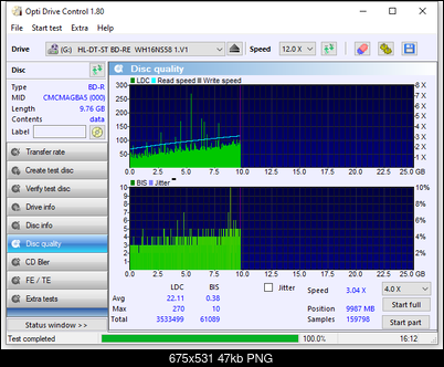

Talking
Recovered, back on 1.V1:
Free, Open Source, Windows/Linux/Mac Pioneer Flashing App-disc_quality_17-oktober-2026-asus-lg-recovered-1.v1-6x-test.png

Glad we got you back and thanks for working with me on it.
