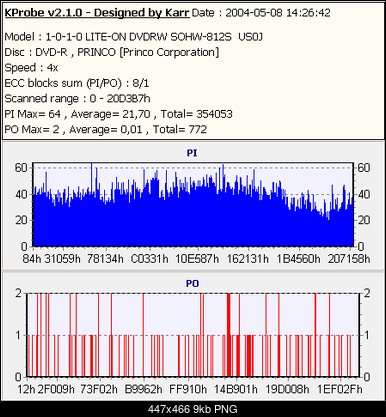

Wpadly mi rece PRINCO DVD-R x4 z nowej dostawy, spalilem jedna na probe a o to wyniki
Disc Type DVD-R
Book Type DVD-R
Manufacturer Princo Corporation
Media ID PRINCO
Protection System None
Region 1,2,3,4,5,6,7,8
Capacity 4,10 GB
Free Size 0,00 GB
Free Blocks 0
Number of Layers 1
Linear Density 0.267 um/bit
Track Density 0.74 um/track
Maximum Read Speed 7,7x
Maximum Write Speed 4,0x
Current Write Speed 4,0x CLV
Write Speed Performance Descriptor 1 4,0x CLV
Write Speed Performance Descriptor 2 2,0x CLV
NOSNIKI DVD-R/+R-princox4a.png
